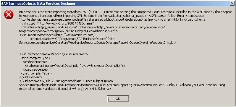

I’m using BODS Designer 14.0.1.142 and have trouble importing functions from a web service datastore I created from a WSDL file.
With some functions it works fine while with others it does not and I get an error message (see image attached).
Because of another thread https://bobj-board.org/t/140205 where someone is experiencing the same problem I think it must be a problem with the WSDL file, but I don’t really understand how to apply the workaround here.
I attached the WSDL as txt file as well.

I am attaching the modified WSDL along with dependent xsd’s files, extract all these 3 files to a folder and try to import the WSDL from the file location and see if that works
I tried with DS 12.2
Other thing is the WSDL is using SoapEncoding, and SoapEncoding is not supported by DS
WSDLUpdated.zip (26.0 KB)
