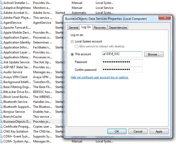

The scenario is the reverse;
BODS services on Local System account works fine for powershell.
It doesn’t work only when the BODS service is run via a network account. Image attached showing that the BODS Service is running via network account.
