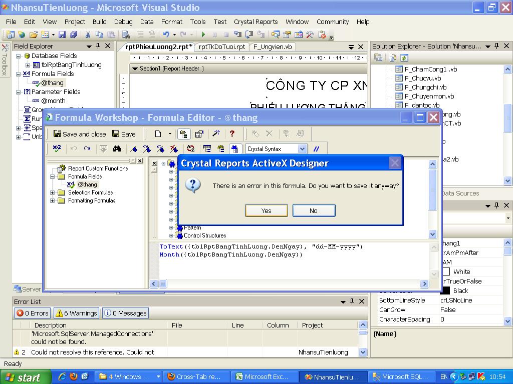

i have a datatable and a field date.
i want to get month from that file
such as this picture i had attach
please help me

Is the field “denngay” date type?
cpmohanraj (BOB member since 2002-09-23)
field “denngay” type nvarchar(50).
ppc0312 (BOB member since 2012-08-13)
You need to convert that to date using Date function and then continue to use your formula on top the date field
i had to try convert to type of date
But the error has occur.
You should use the “Date” function and pass three parameters YYYY, MM & DD.
It will be something like
Month(Date(YYYY, MM, DD))
You may need to create three different variables for YYYY, MM & DD from the field “denngay”
thanks for support. but i think that it begin to make me difficult.
I dont know to declare 3 variables for type of date for it run.
you can for me example.
(my field’s DenNgay is format: dd/mm/yyyy 00:00:00)
Mid(field,4,2)
