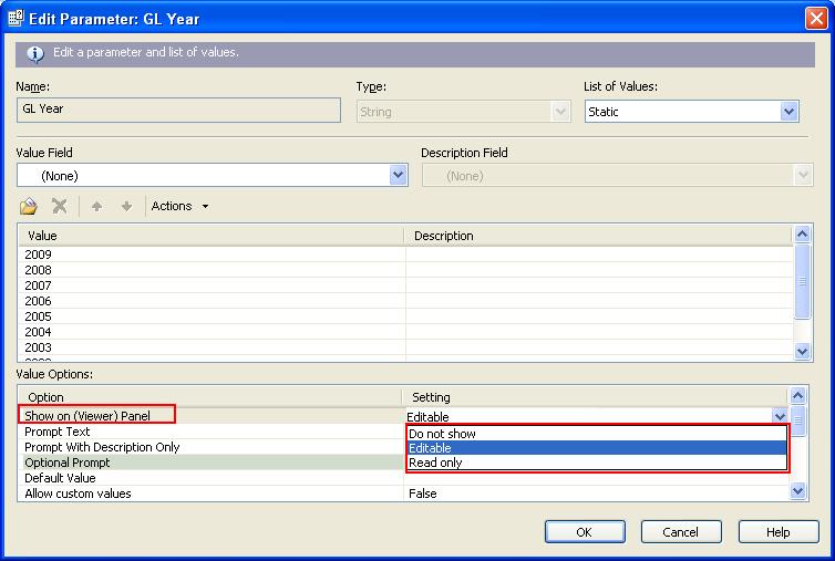

Right click on the parameter in the field explorer and then select the parameter to be shown in the parameter panel. I don’t have the designer in front of me right now but I think the options are: Do not show, editable, read only.

Parameter panel is a Crystal Reports 2008 feature.
When you right click → Edit, under value options, the very first option is “Show on (viewer) Panel”. See attached.
