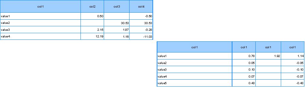

i selected horizontal position relative to left margin and
vertical position relative to table 1.
now the two tables look one below the other in the report. however, when i export it to excel sheet, the two tables are not coming one below the other as in the report. excel sheet shows two tables diagonally as shown in the attachment.
any clues??

Muna :india: (BOB member since 2008-08-05)
I too had such an issue once. Later it got solved but again by working around those options. See this thread as well as the thread given inside it.
Jansi :india: (BOB member since 2008-05-12)
Format all your Table by selecting “Centre Across the Page” or Left Align/Right Align.
Siva.M
looksmee :uk: (BOB member since 2006-02-08)
it is working fine now. the problem was due to improper formatting. thanks all for your suggestions…
