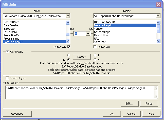

Essentially, I have multiple tables joined together by Outer Joins. Our data quality in our legacy db’s are horrible and this is a must to avoid losing any data elements. I’m defining the Outer Join and the Cardinality Statement is correct. However, when I go to WebI to test it, it reverses all of the Outer Joins and drastically reduces my results.
Example:
dbo.TableA.PackageID = dbo.TableB.PackageID
Outer Join Designated on TableA
Cardinality Statement Reads
“Each dbo.TableA has zero or one dbo.TableB. Each dbo.TableB has one or more dbo.TableA.”

I didn’t mean custom SQL in Webi. I meant hardcoding the join tin the universe, rather than generating it.
What DB platform and middleware are you using?
I really don’t understand what the problem is. Shouldn’t
dbo.TableA
LEFT OUTER JOIN dbo.TableB ON dbo.TableA.PackageID = dbo.TableB.PackageID
and
dbo.TableA
LEFT OUTER JOIN dbo.TableB ON dbo.TableB.PackageID = dbo.TableA.PackageID
return the same result set? What matters is the order of tables in your outer join statement:
dbo.TableA
is of course different from
dbo.TableB
LEFT OUTER JOIN dbo.TableA ON dbo.TableA.PackageID = dbo.TableB.PackageID.
or
dbo.TableA
RIGHT OUTER JOIN dbo.TableB ON dbo.TableA.PackageID = dbo.TableB.PackageID
Besides the word “OUTER” is redundant, LEFT OUTER JOIN could (and in my opinion should) be simply written LEFT JOIN. Assuming of course, you are not using Oracle (in which case Webi usually writes sql with that annoying non-ansi (+) notation)
