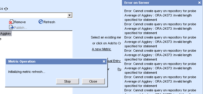

We have BOXI R2 on Windows. We have MHF1. I have a very straight and simple universe with only one table (and it’s NOT a derived table or a view).
I have 2 measure objects with the where clause for creating metrics. I have copied the where clause and also made sure that the syntax is fine.
Anyways here is the where clause if someone would like to take a look.
(ASHAH.TAGG.AGGDATE between @Prompt('BEGIN_DATE','D',,mono,free) AND
@Prompt('END_DATE','D',,mono,free))
I imported the universe and created a metric, until then everything worked fine. But when I try to refresh my metric I get this error
Please look at the attached screenshot.
I even checked the CI_PROBE table and the table does not have any details on this metric refresh. I don’t think the query is even going to the database. I tried creating my own calendar instead of using the default BO daily calendear and that does not work either.

Check ci_probe for the affected metrics. It’s likely that the executable_sql is blank, which is what’s causing the error you see.
If this is the case, turn on all tracing, then re-import the universe in AF. Check the logs for errors.
Joe

That said, ci_probe is one of the PM repository tables. You can query it directly with SQL, or use one of the pre-built Metrics universes.
Within that table, probe_name and probe_code can be used to find the metric in question. Once you identify the row, check the executable_sql column. This is supposed to hold the actual SQL that is used to refresh the metric.
Hi Joe,
I verified it. You are correct. The metrics are not holding the SQL. Its showing as blank.
I tried to Update the universe in metrics. But its not effecting.
Is there anything which I am missing here?
GowthamSen :india: (BOB member since 2006-08-31)
You’ll need to turn on tracing and then import the universe again. Then check the logs.
I found the problem.
When I set the Owner name in Metrics Parameters as “Administrator”, the metrics are refreshing.
I guess its the problem with priveleges.
Thanks a lot joe for your help.
