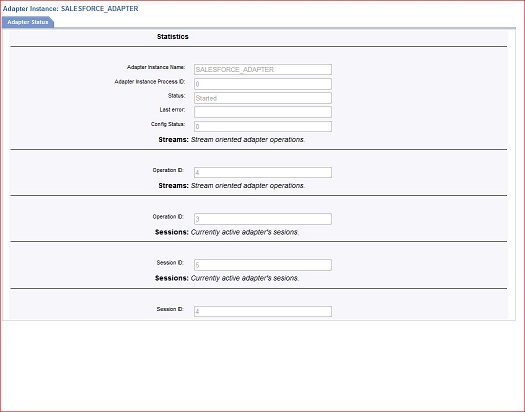

Hi Manoj,
i’ve done your proposed steps.
To have it initial i stopped and started the salesforce adapter.
  1. After start of Salesforce Adapter
    → No sessions are active
  2. After start o Real-Time Job which consumes a Salesforce Table
    → I can see Session ID 3, 4, and 5 (don’t know why ID 1 and 2 are not displayed)
  3. After web Service call
    → I can see Session ID 3,4, and 5 (no visibile changes in session counts)
It seems that not all active sessions are displayed?! And some information is cut off? (See attached picture)
My guess why we are running into problems with TNS after some time…
If we start the Real-Time Service all calls are fine (no further sessions are opened)
If nobody is using this Real-Time Service for a long time, the first incoming request is always failing.
It seems that Salesforce-Connection timed out!? (i finally have to validate that tomorrow)
Second request (with same input parameters) is ok then, but it increased the Session ID (now i can see 3, 4, 5, 6, 7 and 8 ). ← For that i can insert a screenshots later (must wait for time-out)

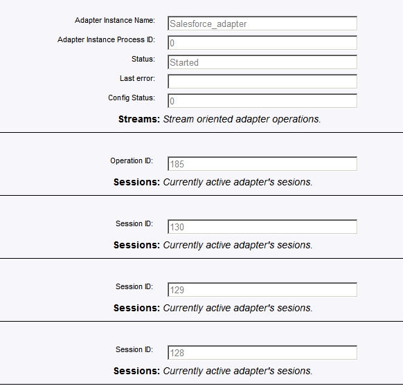

barthodo, I think I may be seeing the same thing with DS 3.1. What is the IP address you are associating with SFDC in the NETSTAT report? Can you provide an example of what you see in NETSTAT?
Here is a small example of what I see:
There are about 74 lines in the report associated with that IP address.
do you also see number of SFDc Session open ?
can you also check the memory usage of the SFDC Java process, you can get the process id from the management console and check for that in the task manager on Adapter JobServer
Yes, I think I see open SFDC sessions. I looked in Adapter Instances->JobServer_1->Salesforce_adapter. There are a number of entries. There are no active jobs at this time so I would not expect to see active sessions.
The screenshot below is only of about half the active sessions.
