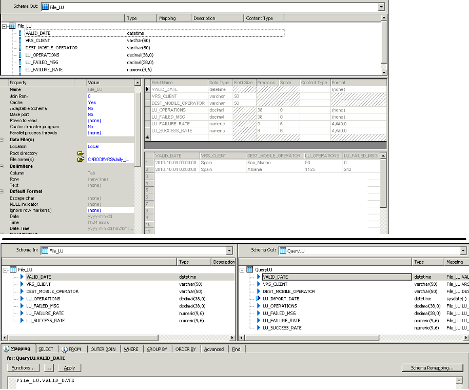

The field IMPORT_DATE is not in the source. I’m using the function sysdate() in my query transform to set the IMPORT_DATE in the target.
The source contains the field VALID_DATE only. Please see attached my Source File format and my query transform.

I’m not sure what’s going on now. Given the following update statement it looks like DI continues to think your column is a string.
