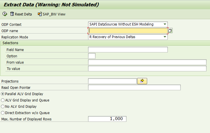

Thanks Werner for the reply.
So, How I can pass different project name as I don’t field for the same. Also, what are the fields name Projections and Read Pointer for ?
If possible, can you please check the attachment and let me know, how to make use of each field
