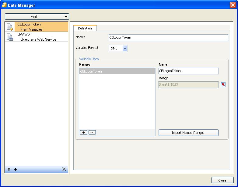

I would also test row restriction set by creating a QaaWS with the exact same universe objects as the webi document. You can then implement the CELogonToken flash variable on the xcelsius model to pass on the InfiView user information to the xcelcius dashboard which will then return the data for the particular user based on the row restriction set. I am assuming that your restriction set is designed using @Variable(“BOUSER”) technique.

Sedtting up the CELogonToken flash variable is pretty straight forward. See the attached screenshot. Just point it to an empty cell on your Excel model. Once a dashboard containing the CELogonToken is deployed to BusinessObject Enterprise repository, it will inherit login credentials from InfoView and then pass it to the underlying query. If you have a row level restriction set on the @Variable(“BOUSER”) in the universe and you are using a query designed against this universe on your dashboard, it will apply the restriction set.
