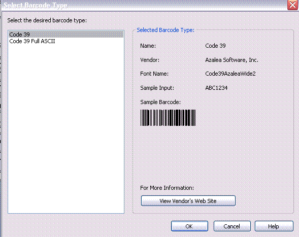

I dont’ know much about barcodes and so this might not be the same thing but in in Crystal Reports 2008 you can natively convert fields into barcode formats. See the attached screenshot direct from CR 2008.
