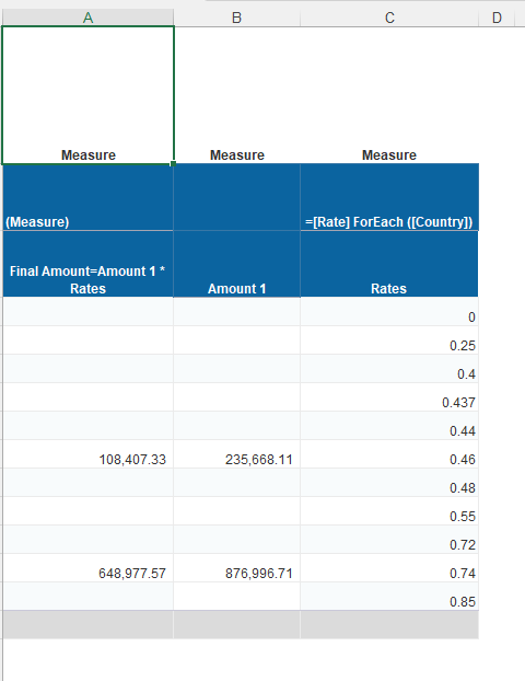

Hi Mark,
Thanks for coming back, I have attached a screenshot maybe to help with the issue
When I delete Columns B & C I was expected Columns values to sum but I end up with Mutli Value issue
Again Many thanks
Zahed
I take it you’ve used ForEach ([Country]) to give a [Rate] for each row, which is why you’ve got blank rows where there are no amounts?
That makes Rate a dimension, a bit like price. While it’s a number by format, it’s actually a dimension.
What does just =Sum([Rate] * [Amount1]) give?
I’d hope it is 757,384.90 so that it is adding your two Final Amounts.
If it’s giving 1,335,197.78 then you’re adding the rates first then multiplying by the amounts.
Each Amount1 looks like it has its own rate, so you shouldn’t need to worry about [Rate] getting confused between them.
