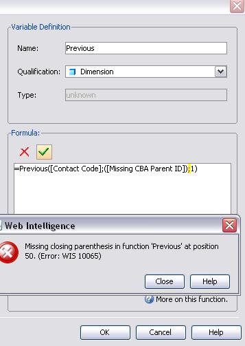

@dorothy: Check the screen print attached. Each ParentID has multiple Contact Code as is in your case. Check the error it returns when i am trying to implement the previous function. :hb:
Am i missing something here? I still think the “;1” is not part of the Previous function. Can you please provide the Webi version of the same formila :?:
boe_bods :india: (BOB member since 2008-03-14)
