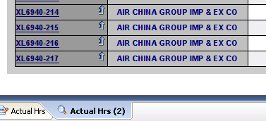

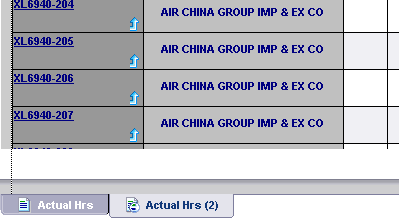

I have a table in my report, with drill down.
In the Edit mode, that shows me all rows/information. And everything is ok.
But in the User model, when he opens the report, in the second drill down, some rows are missing, the report doesn’t show those in the second page.
I attached the problem and the edit model when show correct.
I don’t understand why in the edit model is correct, and in the other not. For the same information, drill down… but the rows are more large and some missed.
How can I fixed this?
