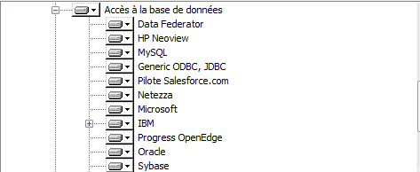

I have a problem, i am using BO XI 3.1 and on designer I have to make the connexion with the middleware PosgreSQL as my database is on this. But this middleware is missing ??? Is it normal ?? Can I add a middleware and if it is possible how can I do it ?
Also, I’ve tried to resolve this problem by using a generic JDBC connexion, in Designer it worked. But when I tried to do a report on Desktop Intelligence I had this error : ā€œException: CS, Specified network layer is invalid : JDBCā€. After searching on internet I’ve found that this version does not support a JDBC connexion.
So I’ve tried to used a generic ODBC Connexion, it worked on Designer but when I tried to do a report on Desktop Intelligence I had this error : ā€œException: DBD, ERREUR: la relation Ā« cssy_objectinfo Ā» n’existe pas;No query has been executed with that handleState: 42P01ā€

When I’ve installed Desktop Intelligence, I’ve selected all the ā€œAccess to DataBaseā€ and PostgreSQL 8 does not appear. But I’ve installed the driver on my computer ā€œPostgreSQL, PostgreSQL ANSI, PostgreSQL Unicodeā€.

Looks like it’s supported - maybe uninstalling and reinstalling your BO client tools will allow you to add other middleware connectors?
It does not appear even when I re-install it. How can I know on which Service Pack of BO XI 3.1 ? (I know that I have the BO XI 3.1 Client Tools). When I searched on internet it says that : ā€œFor the Designer stack, PostgreSQL 8.3 is supported on both ODBC and JDBC starting from version BOE XI 3.1 SP2.ā€ http://scn.sap.com/thread/1510186
