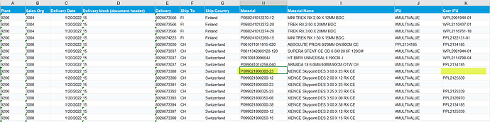

I have a report out of 2 universes. (pdf example attached)
Merged on several fields and works well.
Now the field IFU gives me multivalue error.

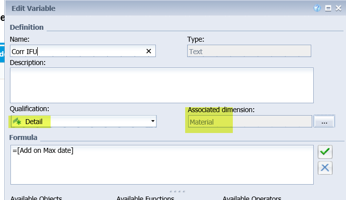

I tried getting this in from query 2 by making it a detailed field on the merged dimension ‘Material’.
This does not work because as you can see in the example query 2 has multiple dates for the outcome.
Guess that is why I am getting a multivalue.

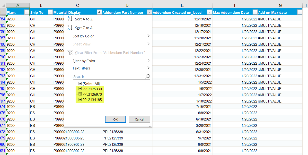

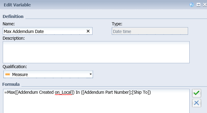

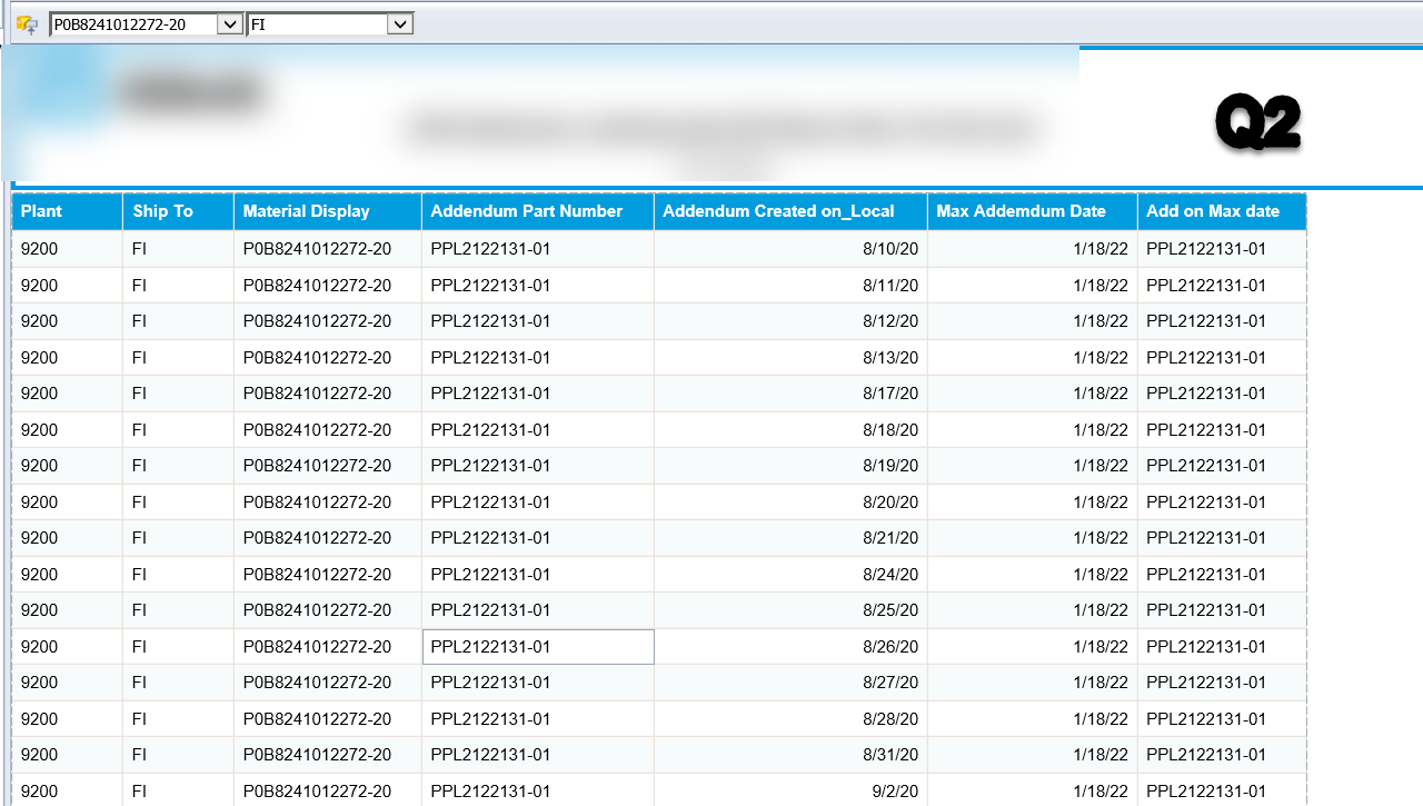

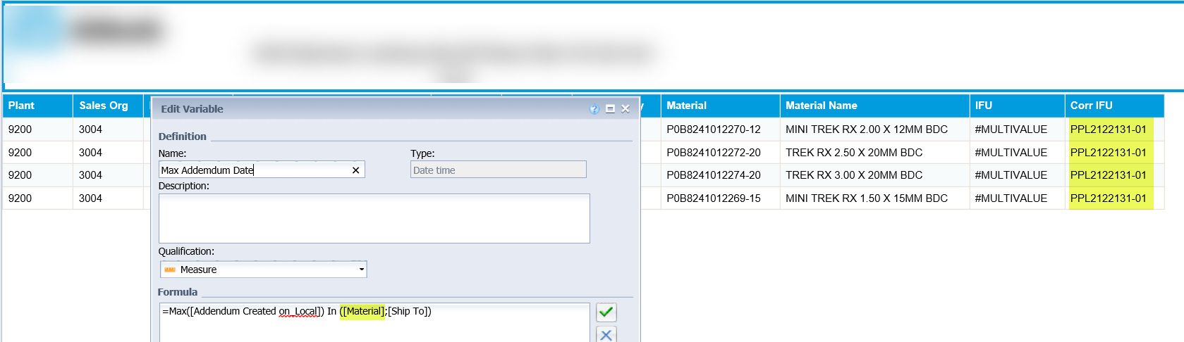

Therefore I first made a field Max addendum date by getting the max date for combination addendum part number and ship to. (Because the addendum part for a material is also dependend on the country).
This gave me as you can see the max date in the report for this combination.

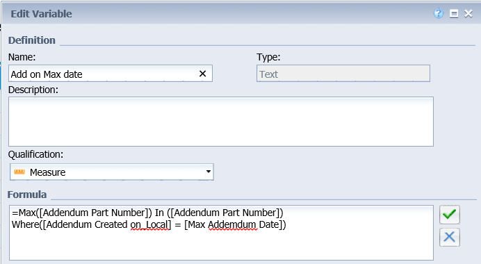

With that date I made the field Add on Max date.
Now In Q2 I seemed to have the correct Addendum part so I now tried making the field ‘Corr IFU’ for the report on both queries combined.
But as you see no output.
The multivalue error is gone but no output is not really better then multivalue error :wink:

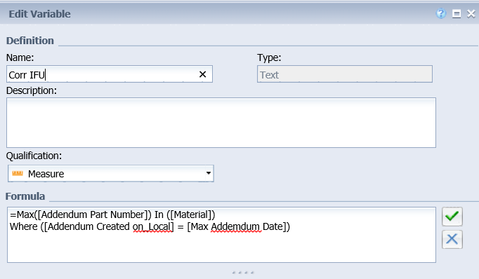

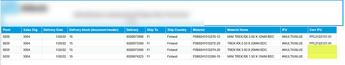

Ok small breakthru when I changed my formula for ‘Corr IFU’.
Unfortunately not 100% solving it…

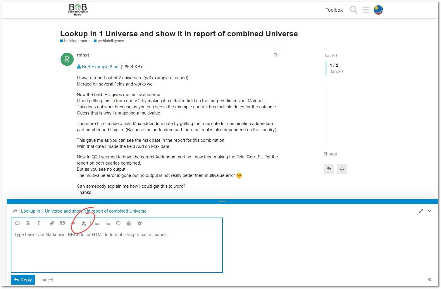

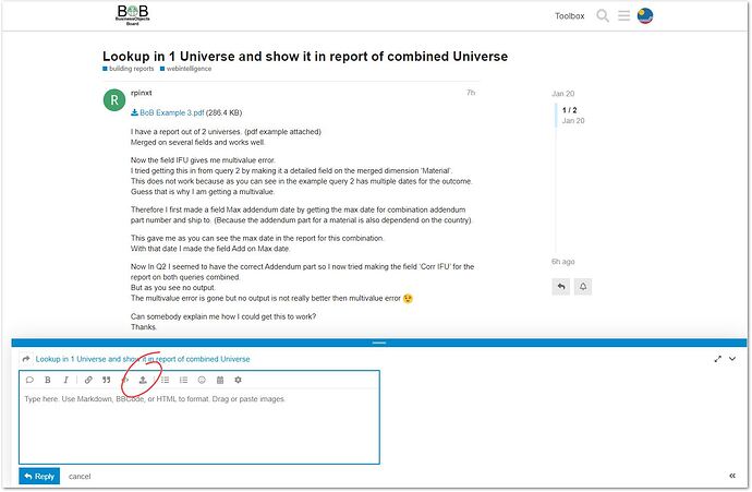

I am not sure how you are uploading these PDFs; maybe different file types are handled differently. If you upload an image it makes it easier to read your question.
Ok…somehow I thought pdf was the only thing I could upload…
But now even noticed I can just paste in my snagit screens directly…sorry about that.

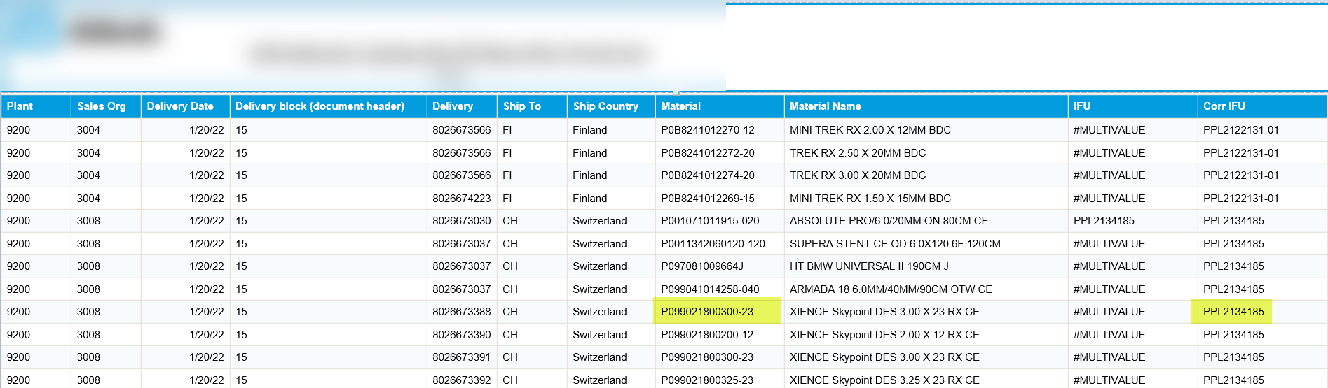

And this is the change I already made to the formula for correct IFU, but still only works 50%…

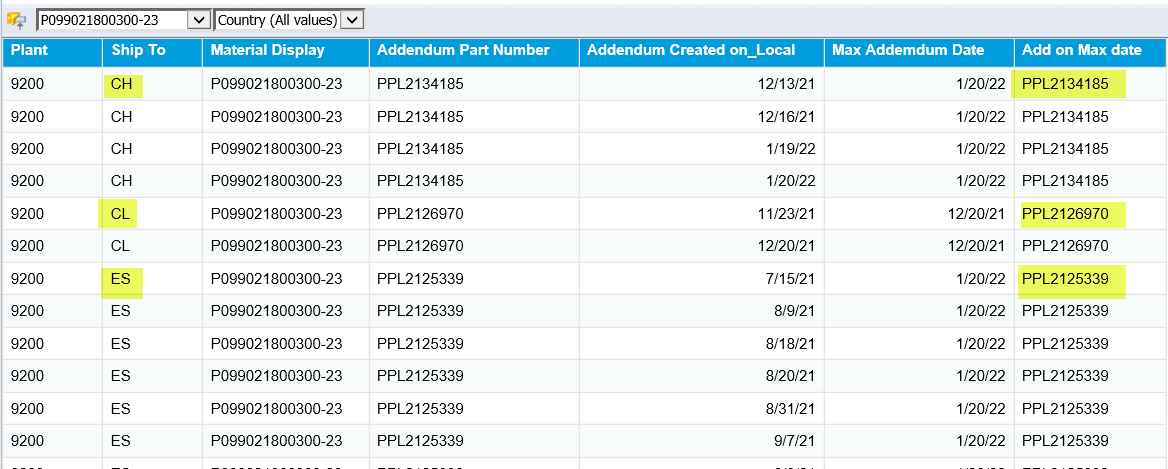

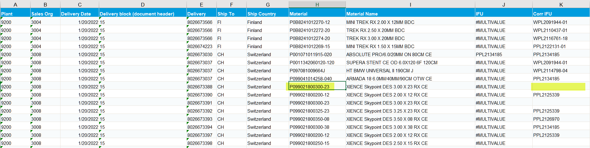

Ok…with some fresh eyes this morning got again a step closer :

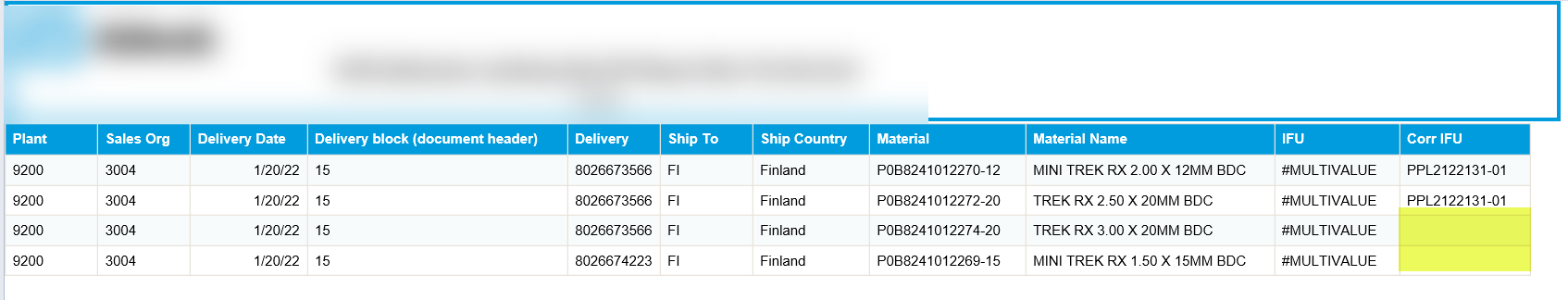

Changed addendum part to material.
Now it seems to work for most but still not all…

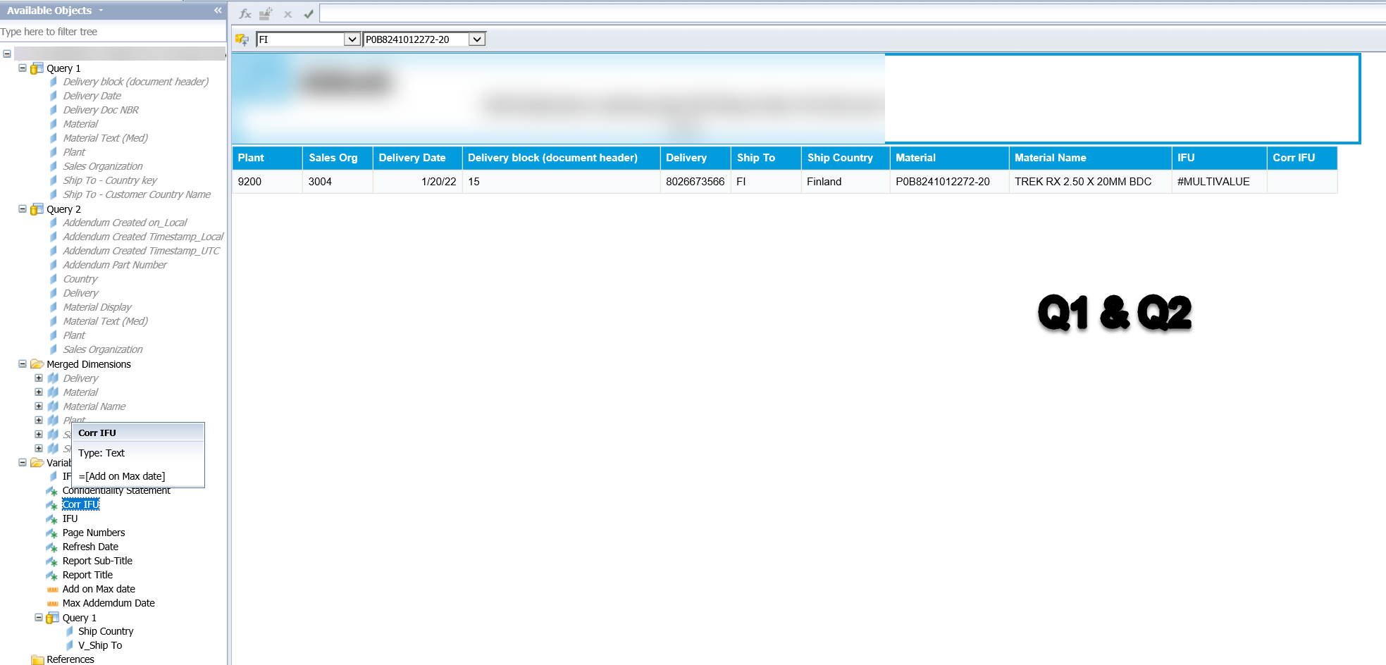

Think it has to do with the fact that 1 material in different countries can have different addendum parts
However not sure why in one occasion it gives multivalue and in another a blank…

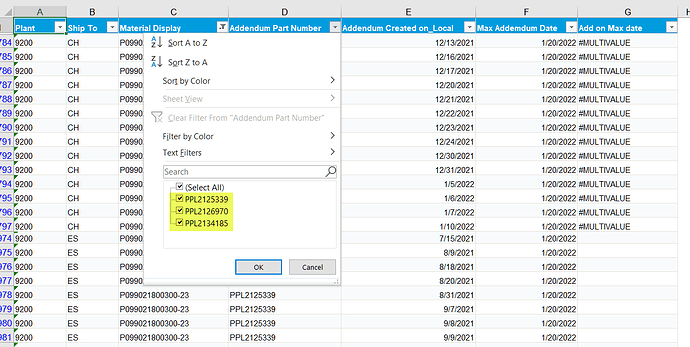

But if you only look in Query 2 it tends to work just fine (but this is filtered on this 1 material!)
Probably making a mess with all these screens but it actually helps me making steps here :slight_smile:

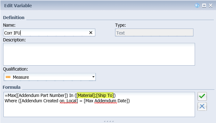

Made me see I also need to make field ‘Corr IFU’ look at material AND ship to
Now these blanks get filled too
Still a few empty but looking at those it seems to be in the data rather then in de BO formulas.
