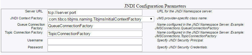

Attached is the snippet of my JNDI config from DS.

make sure you have the Tibco JMS jar that has the initialcontext class and also the QueueConnection and TopicConnection class
for Tibco you will also need to specify the username and password else the queue connection will fail
make sure that the folder where you have copied the JNDI file is also added to the classpath

I have added the tibjms.jar and jms-2.0 jar files in the classpath. Also tried it with username and password but i get the same error.
As per the Tibco side documentation, we do not need a JNDI file (http://blogs.perficient.com/delivery/blog/2014/06/25/jndi-support-differences-between-tibco-ems-and-activemq/), but i have also tried with adding the JNDI file to the classpath. Still i recieve the same error.
