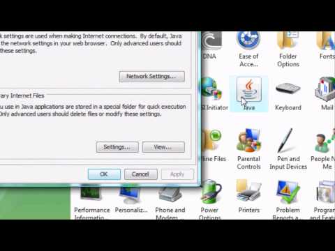

Poster: try following this link:
to see how to increase your Java client memory - instead of the 800m recommended in the video, change yours to 384m, then close all browsers, and re-try your reports.
Other than that, it could be your original report is corrupted or possible had its universe connection broken.
