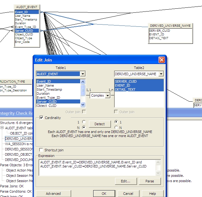

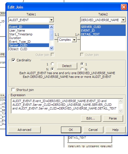

I attended an online course on universe best practice run by Matthew Shaw from BO UK - he is very knowledgeable on good practice and advocates a technique wherby you arrange tables in Designer from left to right in the direction of the 1-to-many relationships. When you do this you tend to find that your fact table ends up on the right hand end. This allows you then to visualise the so-called fan and chasm traps quite easily. For example in this case the audit event table feeds in to the audit detail table as a fan. In such situations you cannot place sum measures on the left hand part of the fan and you can only place count measures if used with distinct. In the universe as supplied the count is NOT distinct and hence we get these errors. I think this is quite poor for a part of the distribution. Count distinct should correct this, but I am unhappy to have my own version of the universe. I believe they should supply a correct one.
I am also not sure about the derived tables that they have created as these appear to imply a chasm trap. There are no contexts used in the Activity universe, so if objects are used from sevaerl of those derived tables, then, without the use of count distinct, they will result in duplicate rows.
UPDATE
Have now gone on to notice that they have not been consistent with the joins to the derived tables. In each of these tables there is a join to the event table on both event id and server cuid. When this is done as a complex join, it gets correctly detected as 1 to many join (event to derived table). Where it is done as two separate joins, then the cardinality of the server cuid join is many to many and this seems to suppress the automated context detection. Once you change these all to 1 to many complex joins, then the context detection springs in to life.
