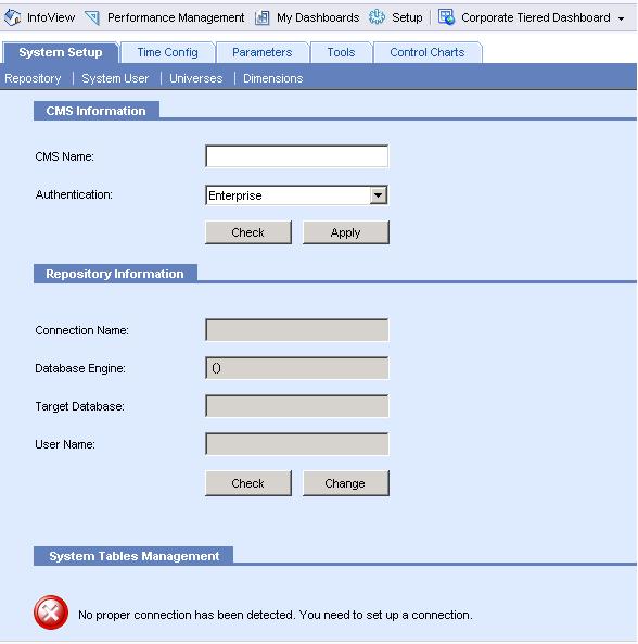

After installing PM, you have to do some setup work here
Infoview->(right angle triangle) PM icon->Setup->System Setup (See the screen shot attached)
What all to configure can be found in PM setup guide.
The cross mark at the lower part of the image whouls be a check mark in green when everything is OK.
bambazooka
(BOB member since 2007-01-26)
