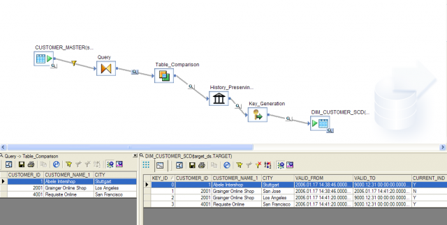

shows exactly that plus an optional valid from/to date column.
https://wiki.sdn.sap.com/wiki/display/BOBJ/Slow+Changing+Dimension+Type+2
