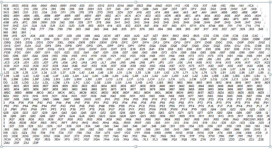

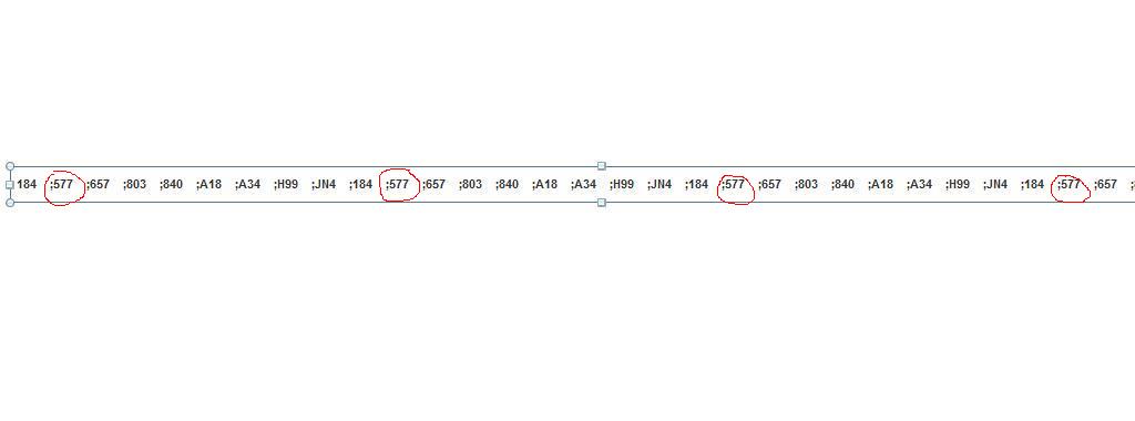

I tried with the logic, But no luck. The values are repeating
=ReportFilter(Country ) Where (Rank([Revenue];[Country])>5)
Other one is #OVERFLOW error

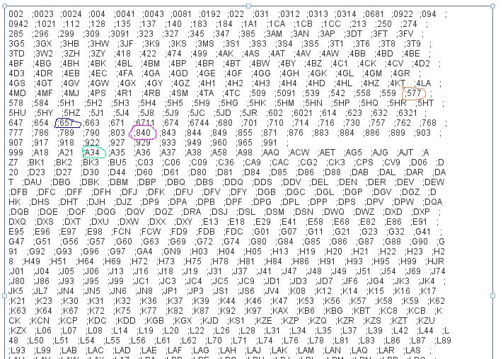

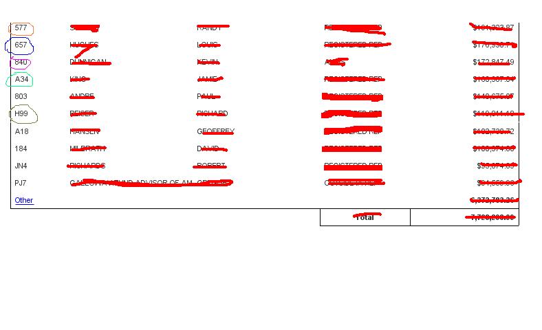

This time the syntax worked but the values are still showing in the reportfilter.
=ReportFilter(Country ) Where ([Rank]>10)
Rank = =Rank([Revenue];[Country];Top)
Please find the screen shots A and B, I highlighted the top 10 in the report filter even if I add > 10.
