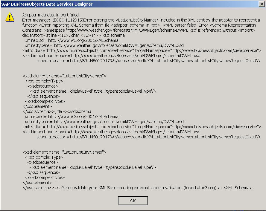

for this you have to check the WSDL that you are importing, is this WSDL for DS Web Services ?
I’m using this url in the “URL of Web Service”-text box in the web service adapter datastore :
http://www.nws.noaa.gov/forecasts/xml/DWMLgen/wsdl/ndfdXML.wsdl
The functions are showns in the External Metadata. When I import one of them, this error message pops up :
[i]
Error parsing the included in the XML sent by the adapter to represent a function <Error importing XML Schema from file <adapter_schema_in.xsd>: <XML parser failed: Error <Schema Representation Constraint: Namespace ‘http://www.weather.gov/forecasts/xml/DWMLgen/schema/DWML.xsd’ is referenced without declaration> at line <11>, char <60> in <<xsd:schema
xmlns:xsd=“http://www.w3.org/2001/XMLSchema
xmlns:typens=“http://www.weather.gov/forecasts/xml/DWMLgen/schema/DWML.xsd
xmlns:diws=“http://www.businessobjects.com/diwebservice” targetNamespace=“http://www.businessobjects.com/diwebservice”>

I am not sure why in your case its referring to target namespace as targetNamespace="http://www.businessobjects.com/diwebservice
I saved the WSDL to the local folder and used the path in the URL etxt field, and I am able to import the functions in both 12.1 and 12.2 version for Adapter Datastore
is BRUN60179179A machine where DS Web Sever is installed ?
while importing funtions from WSDL the request and response xsd will be generated at run time in %LINK_DIR%\ext\webservice folder and imported into Datastore
the targetname space that you see, in your xsd for DS WSDL
BRUN60179179A is indeed the name of the machine on which I’m working.
I’ve Data Services and Tomcat on a Windows XP Professional.
I’m going to test on another machine, as the error message is still the same, even when I enter the path and file name in the URL textbox.
(see attachment)
hsegers :belgium: (BOB member since 2009-06-05)
I think something is going wrong with the XSD creation for request and response, can you try following
on the machine where you are creating datastore
go to the %LINK_DIR%\ext\webservice folder and check if there are any xsd files related to this WSDL
you can either clean that folder or move all those XSD files to a backup folder, the schema location tag will be genrated for Native Web Service Datastore not for Adapter datastore, if I import th same WSDL in a native webservice datastore the schemalocation is coming as absolute path instead of http:// its C:\Program Files …
can you give me the exact version of DS (you can check this form Designer Help -> About Data Services)
I’m working with Data Services 12.2 (the latest version, all components have version 12.2.0.0, repo has 12.2.0.000)
I notice exactly the same behaviour as you have. When I import the wsdl into a native web services datastore, the schema location points to c:\program files… and not to http:\machinename…
is you DS Web Server (tomcat) installed on the same machine as Designer ? or you have distributed env where tomcat is on a different server ?
if your DS Web Server is on different machine, then try the following
copy the DataServices.html file from the DS Web server machine to the Designer machine to the following location
%LINK_DIR%\ext\
or on the Designer machine create %LINK_DIR%\ext\DataServices.html file with the following content
Thanks a lot, that is the solution.
In the DataServices.html file, there was no port in the url. I did not notice it as I have a link in the Favorites of my browser to the Management Console.
Thanks a lot
