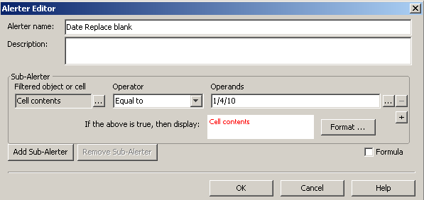

surya_sudheer :india: (BOB member since 2006-11-01)
You can use alerter as well.
When ever you got 06/13/09 that time use blank space for that.
In alter you need to set CELL CONTENTS=‘06/13/09’ that place blank space.
