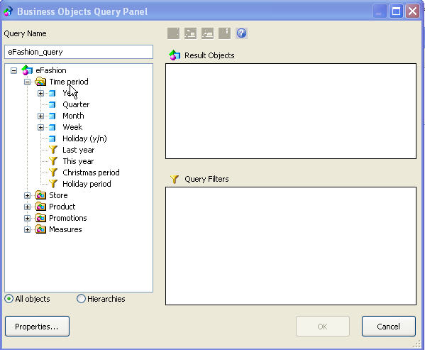

I went to Crystal Report/Data Expert/Edit Command it will opening Query Panel with SQL, Union icon. But I do not see any properties box left hand corner of Query Panel. I am using Crystal XI. If possible could you please send me screen shot for query panel?
Philip (BOB member since 2006-03-02)
I don’t know if the properties tab exists in CR XI, but it does in CR XIR2 and 2008 versions. In any case, I am attaching a screenshot of the query panel in 2008 version using the eFashion universe as demo. Notice that the lower left hand has the properties tab I’m talking about.
AnthonyJ
(BOB member since 2006-06-30)
Thanks Anthony. I think properties tab is missing on XI.
