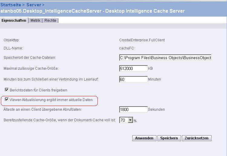

The problem is solved. It was some “cache server setting” unchecked. My BO Admin provided following screenshot. It may help, though it is in german…
EDIT: unfortunatley the behaviour still is the same. It has not been solved permanently by the “server cahce” option. :cry:
