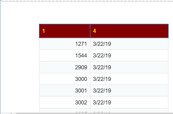

Thank You Buzz for your help. Please find the attached screen shot. When I use the updated CSS file, the column background is red and text is gold.
Now, I need one more thing
1.If you noticed the column boarder is still blue. It should be red.
Thanks for your help.
