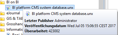

Gotcha - using this Version of IDT: Information Design Tool 4.2
Build: 14.2.4.2410
Version: 4.2 Support Pack 4
if you mouseover the repository ressources - you get a temp popup - difficult to screenshot
presenting: tada… the Revision number (überarbeitet in german)!
  • Wobi
Wolfgang Bidner :austria: (BOB member since 2002-08-30)
see attached png
