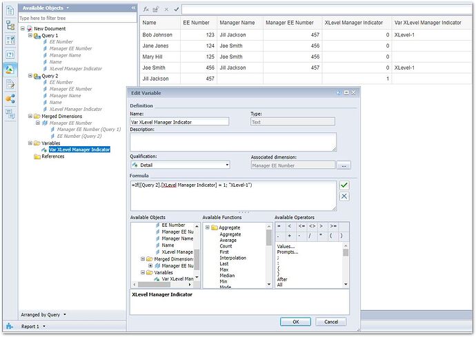

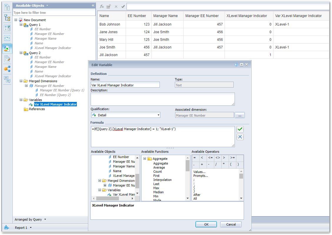

You need to do a second query. It could be a copy of the query you already have or you could trim it down to just Name, EE Number, and XLevel Manager Indicator.
After you have run both queries and are back in the report designer you need to merge Manager EE Number from your first query with EE Number from your second query. To do so click on one of them in the Available Objects pane and Ctrl+click on the other one so that you have them both selected. Then right-click and choose “Merge”.
Now you need to create your variable to check if someone’s manager is an XLevel Manager. Something like this…
=If([Query 2].[XLevel Manager Indicator] = “Yes”; “XLevel-1”; “”)
The key here is that you need to set that variable’s Qualification to “Detail” and set the Associated dimension to the merged object from above.
