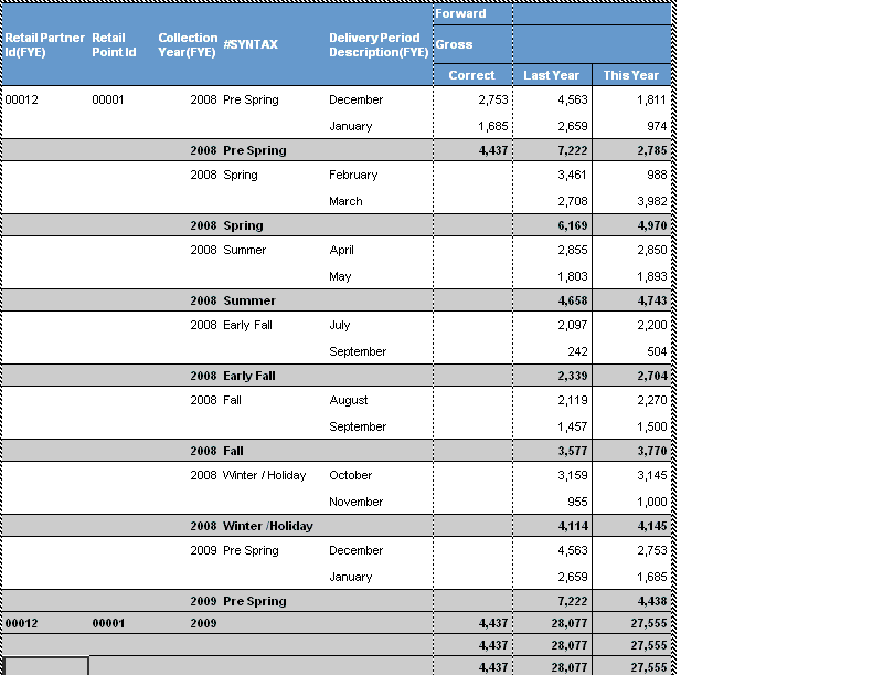

DataProvider 1(this year) takes the turnovers by deliverycalendar months 2006-12 up to including 2008-01.
Dataprovider 2(last year) takes the turnovers by deliverycalendar months 2005-12 up to including 2007-01.
Because I cannot link the deliverycalendermonths of the 2 DP’s, I only take the month without the year. But then I get that the Last year turnovers of december and january are added up, meaning 2005-12 and 2006-12 is summed up and the same for 2006-01 and 2007-01.
As you can see in the attachment, figures appearing under ‘Correct’ are accurate, but Last Year are not for the months december and january. All other months are fine.
nerissa (BOB member since 2007-06-12)
