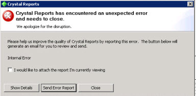

I have upgraded one report with universe which has developed in crystal report 2008 and BO 3.1 to BO 4.0 and the universe is converted to unx format .In BO 4.0 server i want to connect the existing report to new universe ( unx ) through SAP Crystal report for enterprise .
In crystal report 2008 having one option for change universe , but SAP Crystal report for enterprise there is no option for change universe . I tried to map the Result object fields to target data source (unx ) ,but the error will come “crystal report has encountered unexpected error and needs to close”.
