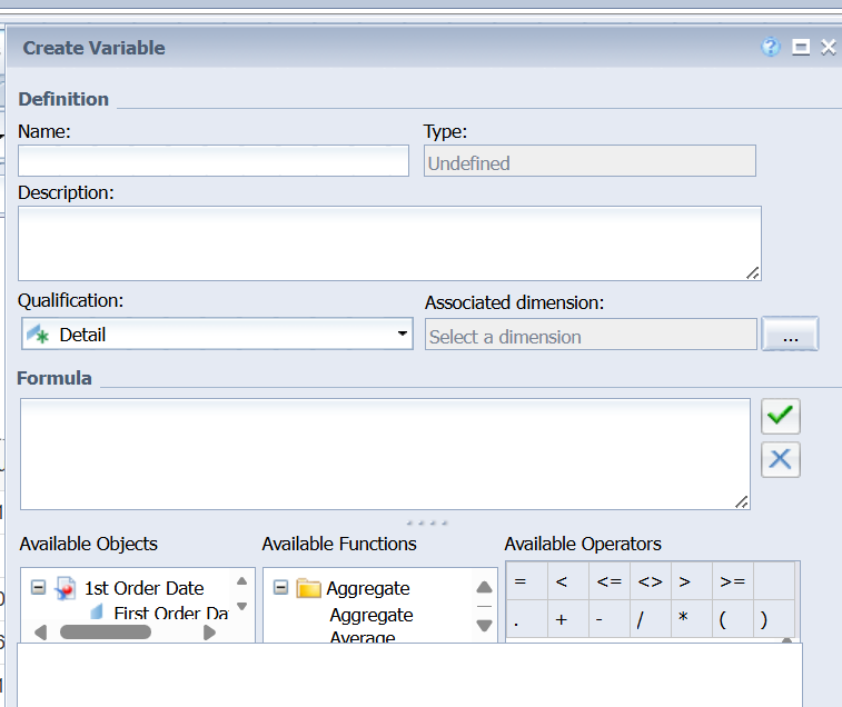

Try creating a variable for each attribute you need to display. I would make the variables a DETAIL of you main dimension (person’s name?).
Then bring each new variable into the table, after removing all dimensions that are causing multiple rows

I think this is what you need.
