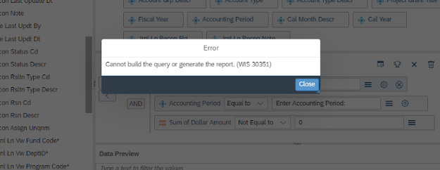

Though I want to consolidate all issues so far in Patch5 in a single post, I want to post that leaving query panel open for around 30 mins and coming back to SAP BO, I am seeing this error…
Did anyone experienced the same issue ?
Srinivas
The default Idle Connection Timeout (minutes): on the Web Intelligence Processing Server is 20 minutes so this wouldn’t surprise me.
Did you configure a different time out for this?
Hi John, thanks for the reply. Yes, I took care of the timeout settings… The regular timeout settings ( leaving BI open for more than 20 mins is working fine). I am seeing this intermittent issue only when the query panel is open. However, as I saw this intermittently, I wanted to check if anyone else is seeing this behavior.
Srinivas
