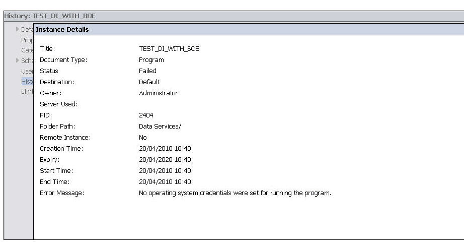

I have been trying to schedule DI (12.X) jobs with BOE (XI 3.1) scheduler.
I have reached a stage where I can see the Data Services folder in BOE. I can also see my ‘Test_DI_with_BOE’ program. However when I right click and schedule the program, it fails. Please see the attached screenshot. Can anyone guide me here?
zigzag :us: (BOB member since 2009-09-13)
open the properties of the ‘Test_DI_with_BOE’ program object and expand the schedule node, under this you will see a option named Program Logon, click on that and sepcify the windows credential to execute this program
you can also set default User from Settings, Check BOE Adiministrator documentation about scheduling Program obejct or check with your BOE Administrator

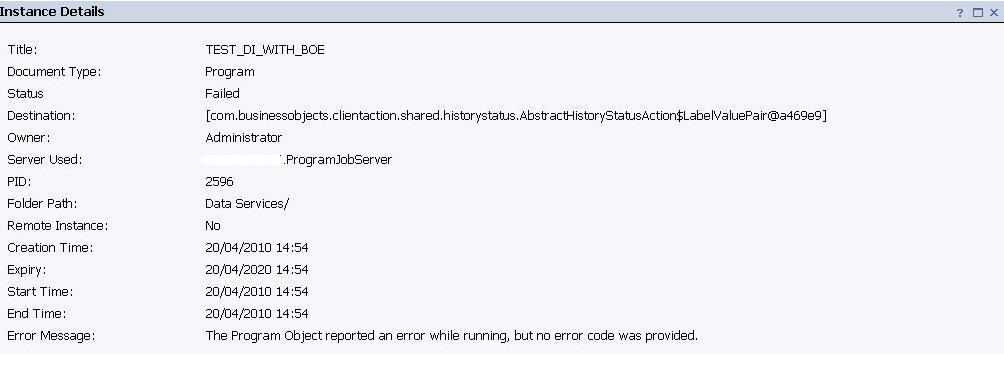

Thanks for your reply. I specified that and now I am getting a different error. Please see the snapshot.
click on the last run date and time link for the Instance that failed, it will open the output file of the process in notepad, do you see any errors in that

How do you do that? When I click on the time instance, all that opens is the screenshot that I have attached with my previous email.
Sorry I am a bit of a novice…
you will see this page when you click on the Status of the Instance, click on the Instance time
check the attachment
