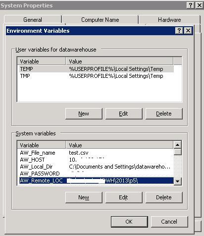

Do we have to set this as environment variable as shown in the attached file. I did that as well but still parameter value do not get replaced in the file :hb: :hb: :hb:

Hey Hey…I found the solution…It was silly me but to help other colleague like me, here is the dummies guide on how to use the customer transfer program to upload the file to ftp location. I hope the same can be replicate for downloading file from ftp location.
Step 1
Create Environment Variable (EV) $AW_FileName, $AW_HOST, $AW_LOCAL_DIR, $AW_PASSWORD, $AW_USER.
To create EV, right click on My Computer, then properties, Advanced and at the bottom you will have option for EV.
Click on New under System Variable and not User Variable.
You can leave the value empty as we can set this up in DI
