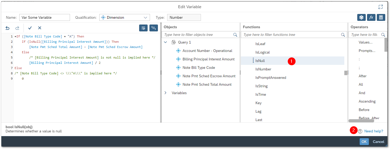

You cannot have a Where clause in an If statement. What believe you want is a nested If statement. Something this…
=If ([Note Bill Type Code] = "A") Then
If (IsNull([Billing Principal Interest Amount])) Then
[Note Pmt Sched Total Amount] - [Note Pmt Sched Escrow Amount]
Else
/* [Billing Principal Interest Amount] is not null is implied here */
[Billing Principal Interest Amount] / 2
Else
/* [Note Bill Type Code] <> "A" is implied here */
0
What version of BOBJ are you using? My text within “/…/” is a comment which is new to 4.3.
You can read up on the IsNull function here.
You can get the same information with WebI here…

I actually think I did get what I need using the nested formula! Thank you for your help!
If you just take out my text between and including “/**/” it should work for you.
