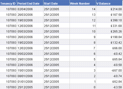

Please see the attached image. In the table I’ve created [Tenancy ID] and [Period End Date] are dimensions brough back from my universe together with a measure of [V Balance].
[Start Date] is currently a measure because it is:
=Min([Period End Date]) In ([Tenancy ID (Tenancy History)])
This forces it to show the earliest date a Tenancy ID has had a balance with us.
I’ve then created a variable that for each and every Tenancy ID ( and I have over 10,000) calls the earliest week, Week 0 and then increments the number up by one per period. So;
Week Number
=Truncate(DaysBetween(ToDate([Start Date]
;“dd/MM/yyyy”) ;[Period End Date])/7 ;0)
I have managed to get Webi (XI R2) to save this variable as a dimension instead of a measure.
So, what’s my problem!? I can’t make [Start Date] into a dimension in the report because it uses Min() and so has to be a measure. When I remove [Period End Date] and [Start Date] from my table, my contrived [Week Number] becomes a Multivalue error.
I think that a way round this is for me to alter [Week Number] to be relative to Each [Period End Date], but that doesn’t seem to work. = Any ideas?! :crazy_face:
At the end of the day, I would like to just have a cross tab table with all my tenant ids in the left column, Week number in the top row and balance in the data.
Any help much appreciated as always

Thanks Lauren, I see where you’re coming from & have tried that previously in similar scenario, just tried in this one again & it doesn’t work.
I think that this is a little bit of a limitation of webi’s but I’m more than happy to be proved wrong. As per my topic subject, I think that my problem could be solved by correctly referencing the context within which my resulting week number sits.
I’ve been attempting to work with the foreach() statement for most of today trying to get a table with tenancy ID, week number and balance in it, and that data alone - and I just can’t do it. This definitely works in deski, I’ve used my contrived week number formula extensively in numerous report suites before to create graphs and tables in reports previously with no problems.

Thanks Mark,
Tried & done :cheers: . Spent too much time in webi trying to get it to work I didn’t think of that.
Was a little fiddly to get the contexts right to say the least in webi (I did option b & hovered the mouse over the formula in deski to see the full context) but it now works & I have an excellent report.
