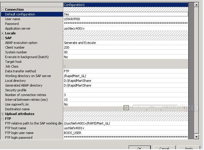

Please note, the “working directory on SAP server” of your SAP datastore is a directory as seen from the ABAP. Given your SAP Server is Linux, it would be a Linux path, not the Windows share!
I am attaching the screen print of the R3_DS configuration.
Appreciate if you can help me correct the same. I am executing the DS Job under the NT user id. Does this account need read/write access to the folder on the file server.

I am stating that in your trace log you will find the line that the ABAP got started but not an ABAP completed successfully line. Hence the problem is on the SAP side. Not related to the JobServer or JobServer computer.
Does the SAP system know the working directory (/RapidMart_GL/) and can it write into?
Thanks for the clarity Werner. I am able to proceed further.
.dat files are being created on the Local Directory now. Data is being uploaded in the Target Tables
