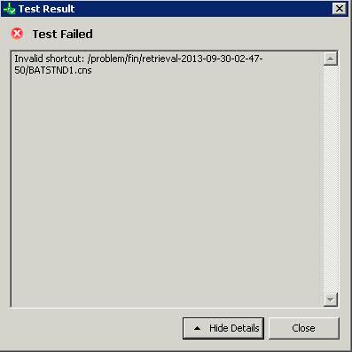

This is the message i get after retrieving the universe, and opening the connection, then we point to the correct DB connection, it works fine. We then post the universe to the repository, after which existing reports show an error
RepositoryImpl.getInternalResourceID() : can’t find InfoObject of cuid AYZqA97yqyNPo2xskJWuj7o
RepositoryImpl.getInternalResourceID(): can’t find InfoObject of cuid AYZqA97yqyNPo2xskJWuj7o[/img]

Finally we had a good news and all reports are working fine now.
The universe is published back to the repository and overwrite the existing one, earlier we used to move the original universe to different folder, and we assumed the report was pointing to the newly published universe, whereas it was pointing to the same old universe.
