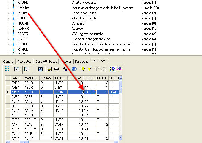

You are using a Rapid Mart.
Go to the workflow (component) C_TimeDim_SAP. There, you will find a script where the company code is set. With this $CCODE we, inside the DF, inside the R/3 DF, read the table T001, the field PERIV and use this as parameter for the SAP function module FI_PERIOD_DETERMINE.
And this function is raising the error that your PERIV value is incorrect, probably because the CCODE is wrong.
(Hope your RapidMart is a version not older than two years. Otherwise the flow will look slightly different but based on the function and its parameters you will be able to track the root cause)

  1. I have a โ€œsuccessfulโ€ job that returns an empty *.dat file - then chokes trying to load NULLs into the Time Dim (Oracle error). The file completes w/o error, just missing the data!
T001.BUKRS seems a valid Company Code, KNA1.PERIV has a matching value of โ€œZ1โ€, what strikes me as wrong reading the generated ABAP is the fields as follows:
