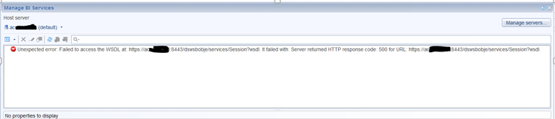

I’m experiencing a error message when trying to set-up a BIWS for my xcelsius dashboard.
When I try to manage my BI services I’m getting:
unexpected error: failed to access the WSDL at https://:8443/dswsbobje/services/Session?wsdl.
it failed with: server returned HTTP response code: 500 for URL: https://:8443/dswsbobje/services/Session?wsdl.

Try to add the server details from “Manage servers” and then click on “Refresh” button. Probably it will solve the issue.

Hello-
I have access to servers, tell me what to do in it. I’m handling admin too. This error I’m seing first time.
Getting following error when I open webI report ( web service publisher ) whereas It works fine for DEV & QA environments
The exact issue as Tiny described. Give me fair solution if you experienced.
