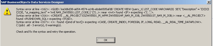

I am getting the error (attached)while importing BODS 4.2 job into BODS XI3.2 repository.
The first two lines depicting AW version are usually changed to desired ones.
For datetime9 datatypes, the names were changed to datetime etc.
Please can you suggest some advise to fix syntax error.
Do we have some useful links to play around this area?

I don’t know how to fix your error. I would be very reluctant to migrate 4.2 code into anything other than a 4.x repository. There is going to be a lot of 4.x syntax that isn’t going to work in 3.x. I think you are going to have to spend too much time to find all the issues to make this work.
You cannot import a BODS 4.2 job into a BODS XI 3.2 repository. Not going to happen and not worth your time. And certainly not supported by SAP. There is no backwards compatibility though you may get away with down one Patch level as Patch releases typically do not contain functionality enhancements. But even that isn’t really supported either.

I understand Erik but just want to read the job. I am sure no major enhancements done on that job to be very honest.
The weird syntax really kills. :hb:

I could manage to see the see the job in 4.2 that fails to get imported into 3.2 repository.
After changing the ATL lines from
#__AW_Repository_Version ‘14.2.0.0000’;
#__AW_Product_Version ‘14.2.1.3’;
to
#__AW_Repository_Version ‘12.2.0.0000’;
#__AW_Product_Version ‘12.2.1.3’;
and replacing DATETIME(9) with DATETIME, I tried to import it failed with syntax error.
I noticed in 4.2 that in dataflow target table was crossed out. So I dragged and dropped the table from the datastore again after removing that in workspace.I validated the flow and it did not throw error.
So exported the job into an atl file and tried to import it.
It fails with syntax error
near found expecting <’)’,’’.>.
There is no inner and outer join and pretty simple mappings used with no new features implemented.
What could be the issue now and how to fix it.
