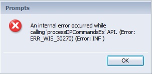

Getting this error in Business Object Launchpad 4.1 SP4, an internal error occurred while calling ‘processDPCommandsEx’ API.
(Error: ERR_WIS_30270) (Error: INF)

This is a very generic message that can have several causes, I suggest searching the SAP support site and seeing which ones match your specific platform and configuration. We received this message on SP2, so much so that the system was unusable, and it ended up being fixed in a later patch.

Looks to me Union casusing this issue, Still Researching! Thanks
Qaisar (BOB member since 2012-05-22)
Solution: all union prompts properties need to match each other with all kind of check marks.
