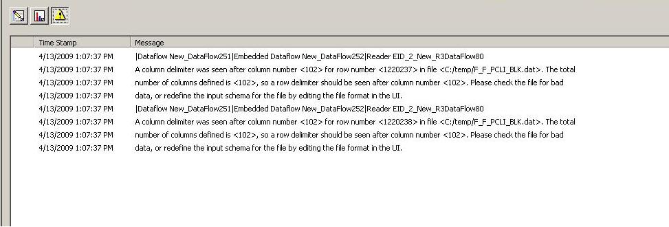

Am facing the following issue while running a job in data servies.
My source is a SAP R/3. The error is as shown in the attachment, am facing this issue only for few tables.
Kindly let me know how to resolve this issue.
Balaji

Hi Werner,
The problem was with a column SGTXT which was having an invalid charater. I did not select that column in my query, But i should increase the column size of some columns to make the job run with out any errors(with out SGTXT column). I am not getting why i should increase the column size to run the job with out errors.
Once again thanks for your support to solve this issue.
Balaji
