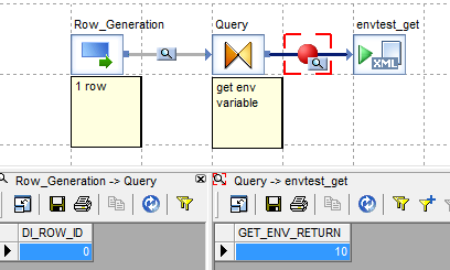

When I try to set a variable in DataFlow 1 and read it in DataFlow 2, the variable is not read correctly in the second DataFlow.
But when running the job in debug mode, the value is set correctly (and also written correctly in the output file.
So it looks like the 2 DataFlows are processed parallel, even they are designed as serial processing.
When check the environment variable with “if_env_set” it returns 0 in second DataFlow.
Can anyone help me here or at least test if this behavior is the same at your BO environment?
