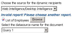

I am using the BO XI 3.1 version 12.1.0.882 and am having problems using a web intelligence document to provide the recipients list, every time I select my report, it says “Invalid report! Please choose another report” after I select the datasource name for the document.
I have purged the data from the webi report, and also set the report to refresh on open.
I tried to make an identical report using the desktop intelligence tool, and uploading this and using this as the dynamic recipients data source, then this actually works, and it is using the same SQL resultset.
Does anyone know why I am having problems using a web intelligence document as the dynamic recipients source, when I can use a deski documument without a problem? I think that this functionality used to work for people; people have made publications in the past in my company using one report and another webi report for the dynamic recipients, but now when they try to make a publication using those same two reports, they get the invalid report error message.
Is there a way to get a more detailed expansion of what the “invalid reports” error message means?

The existing publications still work, it is just the new ones cannot be created with dynamic recipients, even using those same reports, because when I try to choose the query after choosing the report, then it gives the message about it being an invalid report. I attached a screenshot of where the error is, if it helps any.

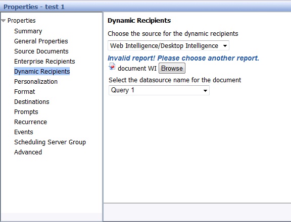

I had the same issue but I have this SAP Note had the answer.
http://service.sap.com/sap/support/notes/1725497
Michael
michaeldaynes (BOB member since 2013-01-10)
That note basically says that you should put a limit on the burstmap. In properties, you should set the maximum retrieved rows to a value greater than the number of lines you’re expecting.
It doesn’t work for me though.
What does work however, is to restart the BO server – until such time, you can use a DeskI report as your burstmap.
