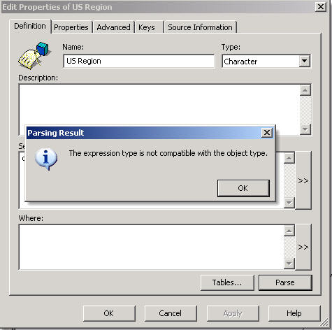

However, some of these objects have long strings. Hence they give a parse error “The expression type is not compatible with the object type”.

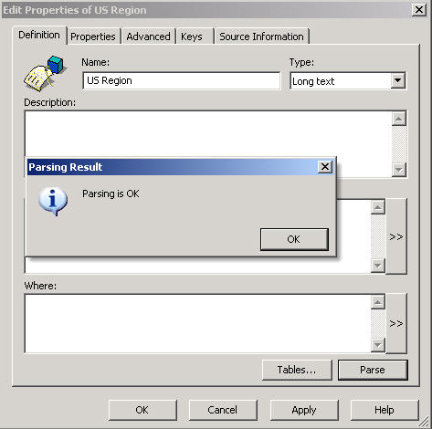

However once i manually set it to long text, it parses fine.
I see no such option for Long text in DsObjectType to set this up through SDK.
