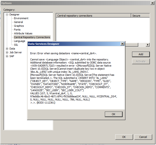

Dear All,
When I am trying to Add Central repository Connection but unfortunately I get the error in attached
Can someone help me with this issue.
Thanks in Advance

Dear All,
the solution about this problem is here —> BODI-1112361 - Error when saving datastore
