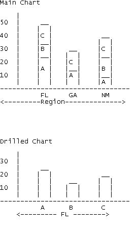

I have a webi report created from a universe. This report has a stacked bar chart.
On X axis I have Region, on Y axis I have Count of employees(CNT). And then we have a stacked contents as Dept.
Hierarchy in Universe → Region → Dept
Preview 1 → See Attachment → Main Chart
Here FL is region, A,B,C are depts. That means FL has 20 employees in Dept A.
I have a drill down for this report. I drill by using the hierarchy Region-> Dept. Well and good, it drills down further to Dept and gives the counts.
Preview 2–> See Attachment–> Drilled Chart
What I wanted is when I stop drilling down at Dept like above for FL, if I click on the bar with Dept A, I want to go to another Webi report where it gives the details of the 20 employees in the Dept A. How can I achieve this?
